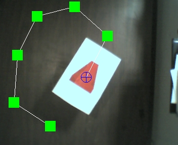

Hi people, I started with this software since a week ago and it seems to me very userfull.
I was going through the path planing tutorial (I have the boebot and the eb500 like the tutorial says)
RGB Filter
Fill Erode
Blob Filter
if....
RGB Filter
erode
set waypoints
endif...
math
path planning
VBscript
[At this point everything works well.. Like the pic.]
But when I introduce the:
Parallax BoeBot Module
The RR runs very slow, I don't know if I'm doing something wrong... The boebot moves, but it just jerks it self..
Even, if I remove all the modules in the pipeline, and just the Parallax BoeBot Module is active, its slows the application.
if a disable this module, it restores again.
I tested for apart  the bluetooth conection with the MSRS C# example, it runs well.
Please, any help will be welcome.
