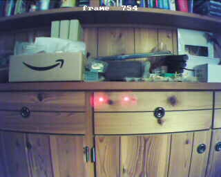

Trying to get the 2 laser pointers and the camera to range find.
By taking the 2 bright spots on the camera image and identifying both there X co-ordinates, it should be possible to gauge how close an object is infront of the camera i.e. the closer the object, the further away from the center the bright spots should be.
Any thoughts on the best way to identify the bright spots from a real background and track the positioning of them?
example picture provided
Have a look at the bottom of
http://www.roborealm.com/help/Blob_Colorize.php
in new version just released.
