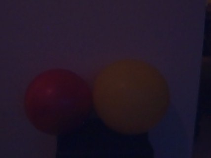

The camera seems to work well in terms of frame rate and signal quality; however, the colors are terrible as the images below demonstrate.  I'm posting this message to ask if others have seen similar washed out colors with these types of cameras or is it likely that there is something wrong with the one I have.  More to the point, if you get good colors with your wireless camera, please post the model.

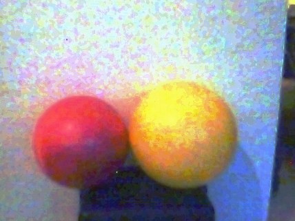

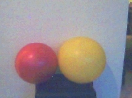

I am posting 6 images.  The first three are from a Creative Labs Live! Voice USB webcam connected directly to my computer.  I have all the auto settings turned off and the exposure turned all the way down--that's why the first "Raw" image is so faint.  However, I find that the RoboRealm color balancing filters give me good compensation while allowing me to obtain higher frame rates than are possible with the Creative auto settings turned on.

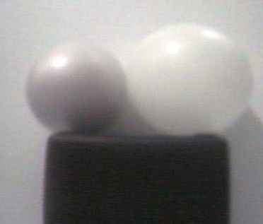

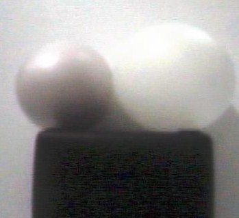

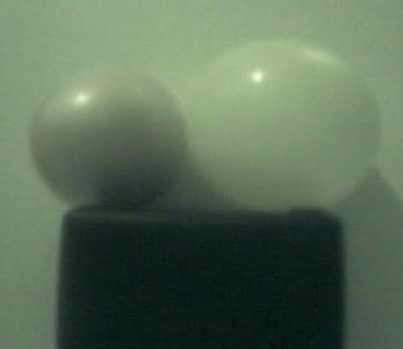

The second set of three images are from the Sparkfun wireless camera.  Note that these images were actually taken using a direct connection via an ADS Video Xpress USB capture device, so it's more of a direct comparison to the Creative camera.
In each set of three images, the first image is the "raw" image without any filters applied.  The second image is filtered through Robo Realm's Color Balance filter (Automatic) with intensity adjustment turned on.  The third image is taken using RR's Equalize Histogram filter instead of the Color Balance filter.
Notice how the filtered Creative Labs images show nice color contrasts between the two balls, whereas the Sparkfun wireless camera images remain washed out.

Creative Labs Live! Voice USB Webcam
1. Raw Image
2. Color Balance filter
3. Equalize Histogram filter
Sparkfun Wireless 1.2 GHz Camera through USB Capture
1. Raw Image

Well, after all that, it turns out the problem was simply the wide angle lens I was using on the Sparkfun camera.  When I put in the original lens, the colors came back...Sorry for the waste of bandwidth!  But too bad for me, 'cause I really wanted to use that wide angle lens.  At least it can be used for motion and shape detection.
