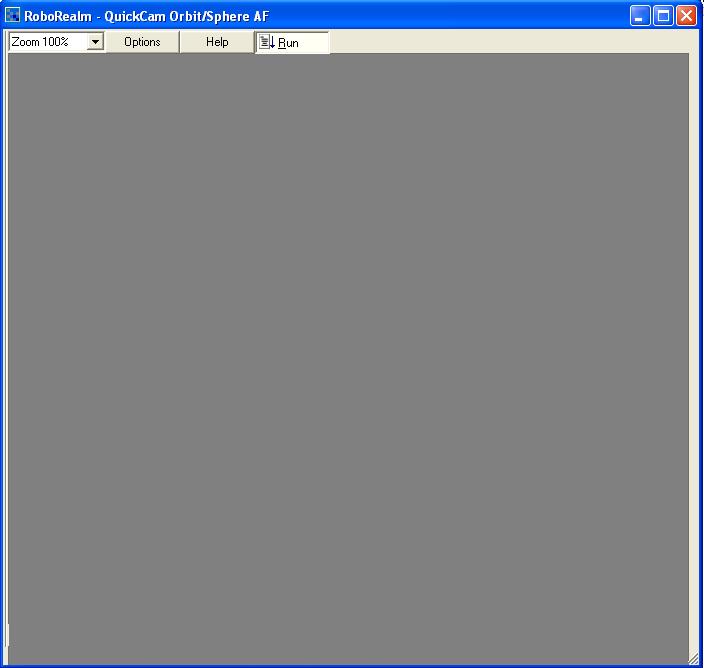

I have just downloaded Roborealm. I have a Logitech Orbit AF.
When i open the roborealm application the main screen just show me a bar with: zoom combobox, options, help and Run buttons, and the rest of the form is gray. I can see some buttons blinking in the bottom.
Anyone can help?
Yes, it seems that the splitter bars are off center. Try holding down the CTRL key and then run RoboRealm.exe by double clicking on it in the folder. Using CTRL while starting up RR forces it to reset its windowing.
Let us know if that works ..
That worked great! THanks a lot!
