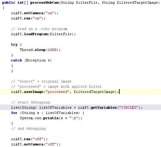

i have tried using roborealm's API with java.

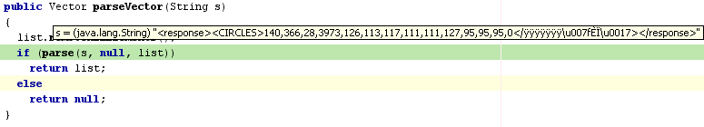

if rrAPI.getVariables("CIRCLES") is called then null is returned. it seems as your software malfunctions. if you have a look at the debugging picture, you will see that the XML closing-tag is not proper of the <CIRCLES> tag!

Can you attach your robofile to help us in debugging? It does look like there is some memory corruption in creating that return string array. We've checked and tested the code but nothing obvious jumps out. It is most likely another module causing a conflict with the API routines. Having your robofile will help us to replicate this issue.
I assume you are using the get_variable API call? Or the get_variables (plural) call?
sven,
Cancel that last request. We found a problem with the get_variables (plural) API call and were able to replicate your issue. We have already uploaded a fix. Please download RR ver 1.8.5.7 for this fix.
Thanks for the bug tip!

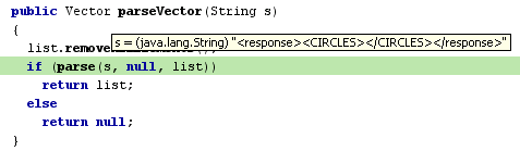

thanks a lot for your support. i have downloaded the new version and the problem seems still not solved. now, the <CIRCLES> tag is empty?!
i have attached you some code and the robo file.

the uploaded robo file is fine. have i forgotten any tags for the handling with getVariables(..)?

sven from Switzerland  [4 posts] 18 year
oh, i am sorry. this time it is my fault!
here in switzerland the sunset has already begun i.e. the light is not the same anymore for my webcam. conclusion: the rgb-filter had to be reconfigured to recognize the red cirle in my test environment!
thanks again for your support.
