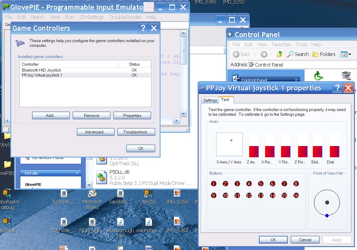

I have a problem to pick up the second HID in the RR.

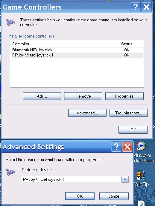

I am trying to connect a wiimote into RR. The bluetooth connecter will automaticly occupied the first HID spot but there is nothing in it. Then the virtural PPjoystick will become the second HID. Even I set " prefer to use PPjoystick". RR still can't pick up it.

You can see ppjoy is the secondary joystick. I want RR interface joystick module to pick up the PPjoy.
Not the bluetooth HID joystick.

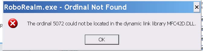

By the way, the RR debug revison seems miss file.

Can you try uninstalling your bluetooth HID joystick and see if RR even works with the PPJoy driver? Just want to be sure that the virtual joystick actually works with RR before continuing.
STeven,
The PPjoystick works with RR as long as it is the first joystick in the system.  The only problem is the bluetooth HID driver. It always jump to the top. And I have no cure how to map it.
I hope you can modify the RR to pick up secondary joystick or even further joystick.
Calvenn
Thanks.
If you download the latest ver 1.8.4.2 (just uploaded) you should see a device dropdown in the joystick dialog that allows you to select one of the joysticks. Note that this module was also improved to acquire joysticks that are plugged in after the module is running ... just select the device menu and it will refresh.
