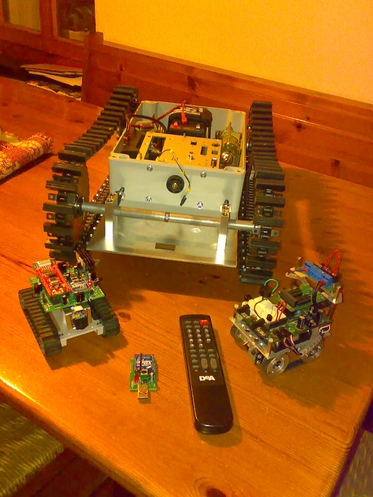

I would want to be put in contact with other possessory ones of Surveyor SRV-1 for being able
to resolve some issues: programming, lighting system, ricopertura hello Roby from Italy Venice

Thanks for the answer, I would want to connect a led in order to illuminate the nocturnal scene to little centimeters from the robot and to be able to ignite it and to extinguish from the consul of roborealm Roby thanks
