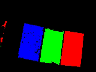

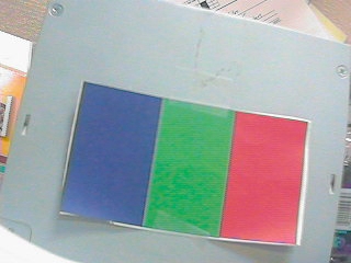

Take a look at the attached pics. I created a picture in paint. It is red,green. and blue blocks all touching each other.
The RGB filter picks them out, but the Blob filter shows nothing. I'm using the exact robo file you posted on this thread. Any ideas what needs tweaking?

Ringo,
Actually the robofile is working perfectly ... the problem is that the script was written to detect blue,red,green bars NOT blue, green, red bars! I've attached the script with the order changed and it nicely identifies the middle green bar. That's what you'd use for detection ... i.e the middle bar.
Give it a try and let me know how it goes.
Ringo from United States  [18 posts] 18 year
OK, I think I get it now. So you have the first blob to track then the 2 nearest. I was assuming it was like object 1 then next to it is 2 then next to it is 3, but it is more like 1 then 2 must touch 1 and 3 must touch 1.
Pretty cool, Now to find myself a colorful shirt :-)

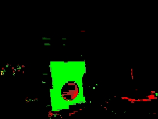

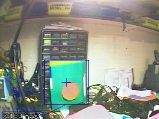

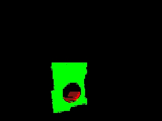

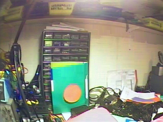

Orac from United Kingdom  [6 posts] 18 year
Still couldn't get the "nearest" function to point to an object. It always blanks off the selsction box or both radio buttons come on at the same time, so I have tried a different method for now.
I am tracking a red blob inside a green blob which is working quite well.
Normalise
RGB Filter, Red, Green
Blob size max 1 object
Blob filter using the around function
Cog
Its working quite well, but flickers a lot which I think is due to the camera not processing red colours very well. Also a fair bit of what looks like interferrence lines running through the blobs.
When it comes to driving the motors, I think I will average the cog variables out over a second or so to eliminate these split second flickers.

Orac,
Looks like you have an interlacing issue. Try using the Average filter to average a bunch of images before processing. That will improve the image quality and get the color detection to be more reliable.
