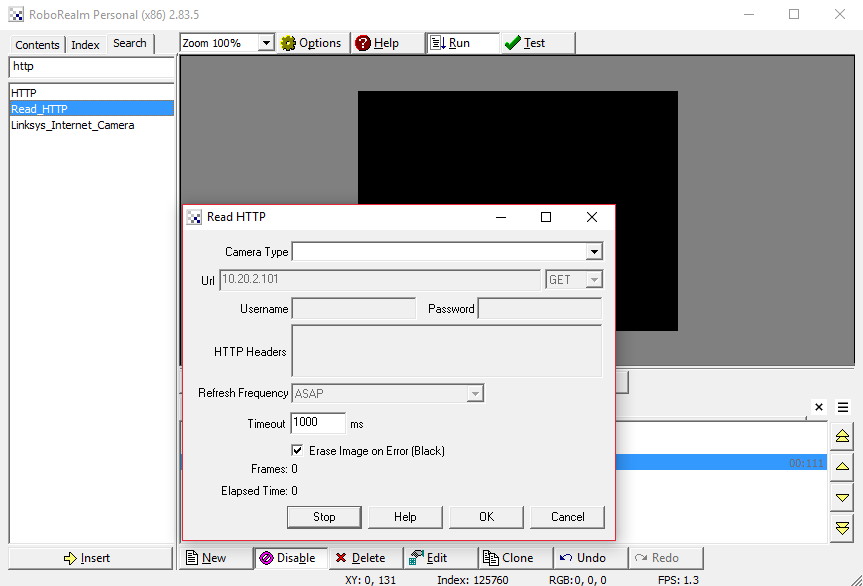

It doesn't seem to work. I put in the IP for the router but nothing happened. At least there wasn't an annoying error message.
Should I pick a camera from the dropdown? The one we have is a Microsoft LifeCam HD-3000, which isn't there.
Tell me what I should do, and thanks for your speedy reply!

You will not see the camera in the dropdown since the HD-3000 is a webcam and NOT and IP camera. We were thinking that the roboRIO does make it into an IP camera but apparently this is not the case or has not been enabled.
You can also try typing that ip address into Chrome/Firefox/IE to see if that does anything too. According to your results it shouldn't since that module makes the same request as a browser does. Perhaps this just doesn't work or requires something else to be enabled. Again, as we don't have this system to test on we are somewhat guessing at what the issues might be.

We decided to try out GRIP, and while trying to get it to work, we stumbled upon a forum post that said to use "http://roborio-TEAM-frc.local:1181/?action=stream" to get the camera. I remembered your earlier post about the Read HTTP module, so I tried that URL and the camera showed up! No errors either!
For anyone trying to get this to work, don't use the FRC Camera Client module, use the Read HTTP one and put the above URL in. Replace TEAM with your team's 4-digit team number and press Start.
