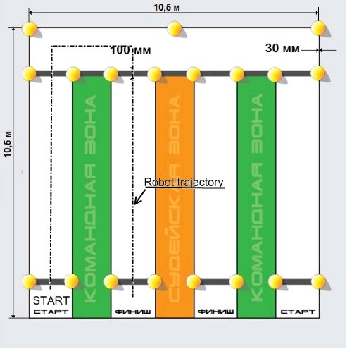

Here, in Russia, we have robotics competition called Robofest.
One of the  tasks of this competition - "Defile"
Robot must go inside track marked with black lines stay inside of two lines.
Floor surface white. Lines are black.
In image i show area of competition plan and desired robot path.
How i can use RoboRealm to slove this task?
I fully new in computer vision technology.
thanks. Sorry my bad English.

Rules:
1. Robot maximal dimension 800x800x1000 mm  LxVxH
Our robot have 650x800x300
2. differential drive with encoder feedback using ROBOTEQ DC motor controller as power amplifier and NI SingleBoard Rio as main controller. Also we can use any kind of PC - laptop, notebook mounted on mobile robot or stay outside area and hawing communication with robot using WiFi. Also we can use any types of cameras
3. No one of parts of robot can cross side lines of track.
Important - we can use camera looking down at line. I add image to illustrate this rule.
And possible to use a side looking camera.
