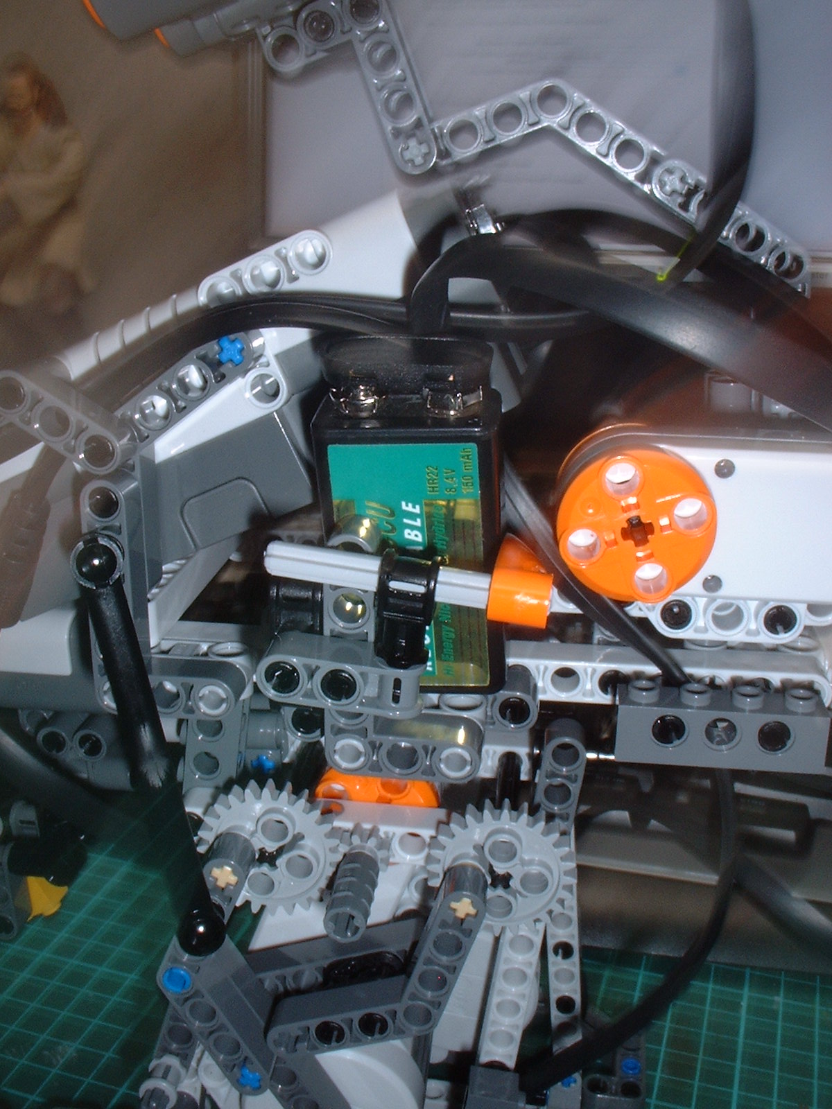

Meanwhile I have some pics of my modified Alpha-Rex:
is the cam and the HiTecehnic-Compass.
upper construction of Gucky
CloseUp of the US-Turn mechanism
Batery-Holder for the cam
I'm waiting for some Parts I have purchased. If they arive I will build some LED Lamps because my Cam has sometimes Problems with the light.
So long Greetz, Rincewind
