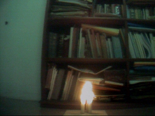

Ive been able to establish the serial communication with my robot but another problem is adding up to my task.
As Ive told u, my aim is to send a Hex code word as soon as the region of interest has been depicted from the image.
the problem is that I am not getting control over my serial port;
when I am including the serial port module in RR,it starts sending the code word whether or not the image haz been recognised.
What I Want is the RR should send /xaa when the image is recognised and /x00 when the camera is not getting the required picture. I am including some of the pictures that I have processed and the program also.

Tawsif,
you were testing the wrong variable. Image_height is ALWAYS the height of the original image. Thus for a 320x240 camera image size it will always be 240.
You probably wanted to test the COG_BOX_SIZE which will vary based on the size of the detected blob. We've include the fixed program. Note that we used a size of 20 which may still be too large but based on the images you provided it seems like a reasonable amount.
