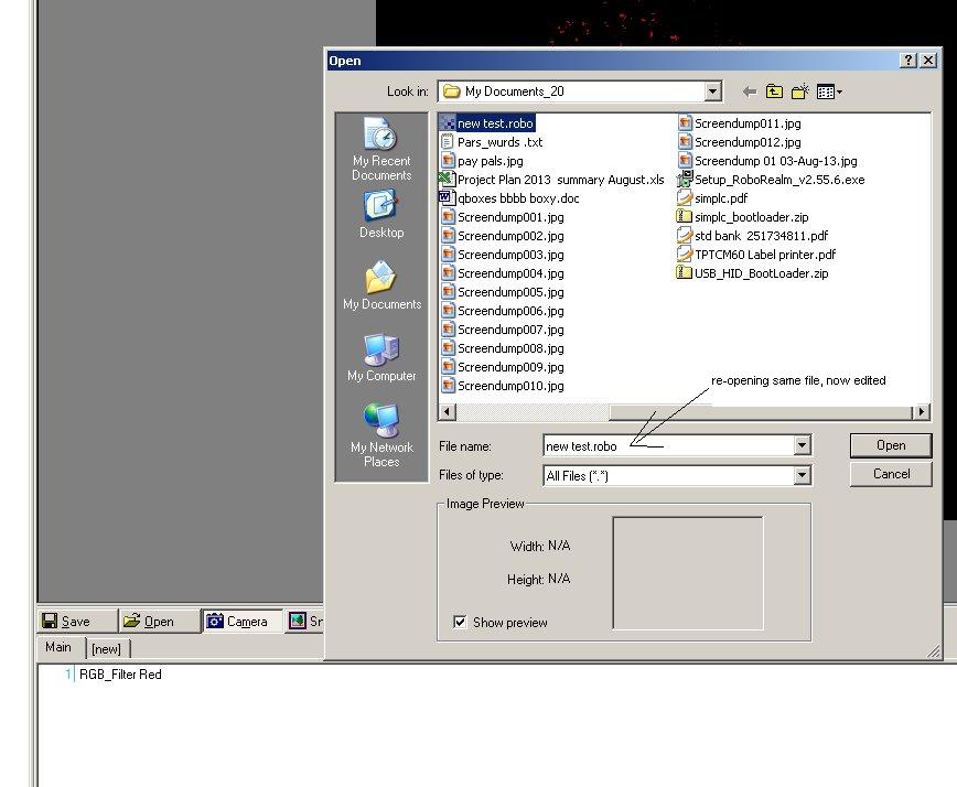

I'm attaching a number of simple screen shots showing the sequence.

Roland,
Thanks for the detailed sequence. That's what we figured you were doing but could not replicate. Unfortunately, we still can't replicate that error testing on our machines. Its possible that you just got a bad copy or downloaded while something else was going on.
Can you download a fresh copy and just load in the new test.robo with the disabled tag?
If you get that same error 'Invalid Tagset ...' there will be an additional number shown. Can you send us the screenshot of this new error?
The problem may be related to your timezone, language settings, etc. which we are trying to determine what that might be.

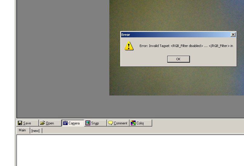

I Don't see a 'test.robo' file if it was meant to be attached. Anyway, I just disabled the last item and saved, re-opened. See attached pic.

That was "new test.robo" which is what you called the file that you saved. I included it again here just in case you deleted it. Its VERY important to use exactly that file since the new debug number is looking specifically for the RGB_Filter.
Something very strange is going on with your machine ... we'd like to know what since this issue may show itself in a different way somewhere else.

Ok, I used attached program. see attached pic.
This morning, as I said, I tried the same thing at my work PC. Thats where I made the file I sent. I'm now opening it on my home PC, and getting the same error.
