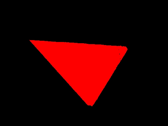

how can i find a triangle direction using RR?
Care to post an image with that question? It will really depend on the image content.
For example if it is something like this
borrowed from this site (not robotics related but we need to give credit)
http://sonohang.blogspot.com/2007/11/uncommon-triangle.html
you could use the RGB filter and then the blob filter to look for a "triangular blob" to result in
See attached robofile.
And then for the direction use the Geometric module and see the angle variable. Note that this only works for an asymmetric triangle as a symmetrical one has no intrinsic angle.
