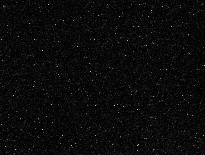

Here are a couple of examples of hot pixel background patterns from long exposures with completely different cameras, an EMCCD and an interline CCD. I know that you could address this problem by subtracting a "dark field" image, but a "hot pixel" filter would be useful for a quick in-line fix.

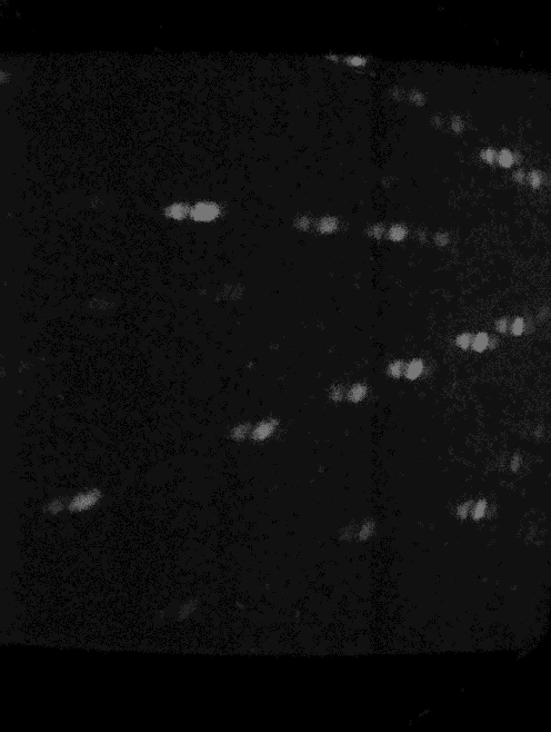

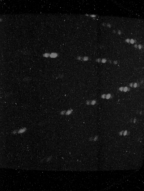

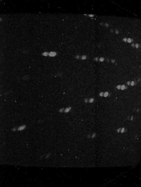

Thanks STeven. Actually I am not looking at stars, but at much more diffuse blobs in a neutron diffraction pattern, so that will make it easier for my case. The previous images were both background only i.e. all of the sparkles are noise.
[image1] is a diffraction pattern (blobs) with lots of dark current noise (speckles).
[image2] is the same salt&pepper filtered on 1 pixel noise by PaintShopPro-X
[image3] is the same salt&pepper filtered on 4 pixel noise
So already a single pixel "hot pixel" filter does a pretty good job, but in my case I could use a larger filter. What would be nice would be to be able to choose the size of the filter as with PSP-X, since people looking at stars, which is common using this type of camera, will have different filter size requirements.

That was quick work STeven. Thanks. Your documentation is also very clear and precise. A couple of comments. First a trivial one - the "down" pixel size control stops at 3 not 1.
I have compared this filter with the PSP-X equivalent, and they seem very similar except that perhaps a little less blurring occurs with larger pixel filters in PSP, which also produces a slightly cleaner result, especially if the "include all lower speck sizes" is checked, and/or the "aggressive" (?) PSP-X option is checked. Looking at the PSP doc. I don't know what "aggressive" corresponds to here, but "include all lower speck sizes" seems like a good option. The PSP-X filter is quite a lot slower too - whatever it is doing it takes a couple of seconds.
PSP also says that speck sizes must be odd numbers, but it does allow even numbers, apparently silently adding 1. (I don't understand the reason for odd numbers). So my "4pix" filter was really "5pix". PSP's sensitivity scale is 1-10, and I used 5 for my examples.
This really is a very useful filter. It makes me wonder whether it is still really necessary to physically reduce noise by Peltier cooling the CCD. Thanks again.
