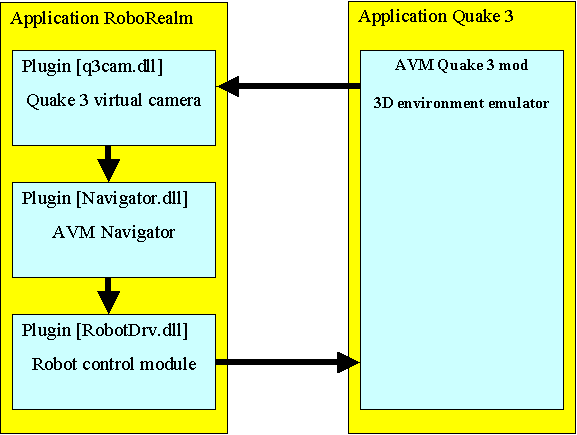

The "AVM Quake 3 mod" provides environment emulation of real world with transmitting of live video to AVM Navigator plugin.
The "Quake 3 virtual camera" and "Robot control module" plugins provides interaction of AVM Navigator with virtual 3D environment.

  1. Start the "AVM Quake 3 mod" (click on "AVM_Q3mod" shortcut at your desktop) and  RoboRealm application with q3cam, Navigator and RobotDrv plugins in video-processing pipeline.
